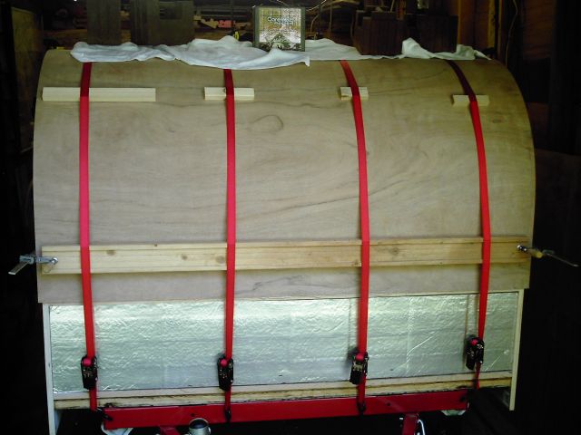

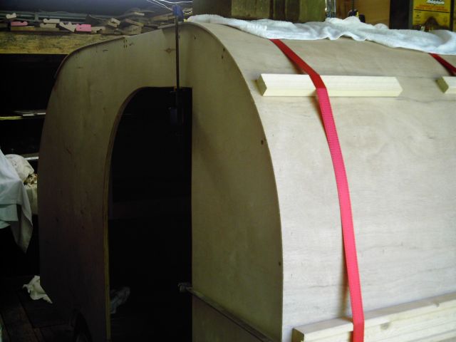

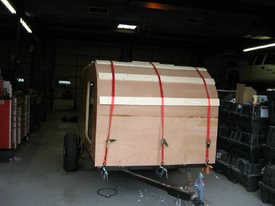

I finally got the outer skin installed. :R
I used Liquid Nails as the adhesive and used my air nailer.
I first attached it at the bottom front of the trailer and then
ran the ratchet straps over it and begain to crank down on
it slowly and evenly. I sat four elevator test weights across
the top to help in holding it down while I nailed it in place.
Those weights are 50 pounds each! Heavy to lift up there. :?

Postby pauld3 » Fri Jun 29, 2007 9:06 am
Excellent work Skipper! That's what we did too, but it took the two of us to get it on and ratcheted down and stuff...I don't see how you did it by your self!!!
This Teardrop building is definately a two person job!!! I think! :roll:

Postby SkipperSue » Fri Jun 29, 2007 9:16 am
Thanks Lynn. :)
I guess I forgot to mention my better half Sue in all this, I took
2 of the straps and she took the other 2 and we cranked them
down together. :R

Postby SkipperSue » Fri Jun 29, 2007 12:07 pm
Thanks everyone :D
Mary K, I don't think it would be possible to get that bend
without those ratchet straps!

Postby SkipperSue » Fri Jun 29, 2007 1:32 pm
Howdy Heikki, :D
I used a construction adhesive called "Liquid Nails". I'm not exactly
sure what it's made of but if you get it on your clothes it will not come
out! :R I first applied the Liquid Nails to every area that the skin
would come in contact with. Then Sue and I (gotta remember to include
her :R ) placed the skin to the bottom and shot a few nails in to keep
it in place. Then I added the holding board and clamps to that. Then we
put the ratchet straps on and begain to tighten it down. After we got it all
tight I started shooting the nails to it. I used a 1/8th" diamater 3/4" long
air brad. I love the air nailer/stapler, I have owned that tool several
years and this project was the first time I have used it. :D
No screws were used at all! I left the straps in place for about a week and a half to make sure the Liquid Nails was compleatly cured.
