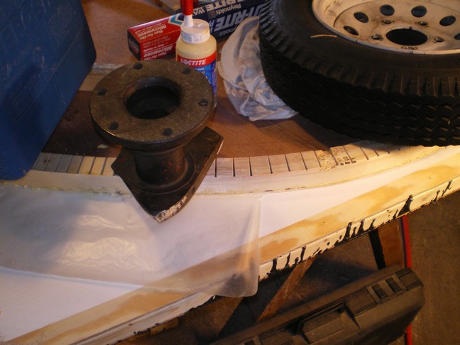

Postby Arne » Mon Jul 02, 2007 12:50 pm
P&L, I'm finding that once I get some wood glued down on it, it lies flat enough so I think when I glue the opposing skin on and weigh it down it should be okay...
I'm gluing one or 2 pieces per day, so hope the next wall goes quicker..
Nest time, I'm going to start with a piece with curl down on the edges instead of edges curled up... I think it will work better..
But, I am making progress.... albeit slowly.
