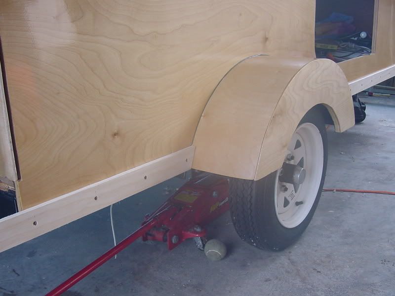

I have mounted a fender. WoooHooo!!
Now, I wish I had not, because I need it off for a template to make the trim that goes around it. :(

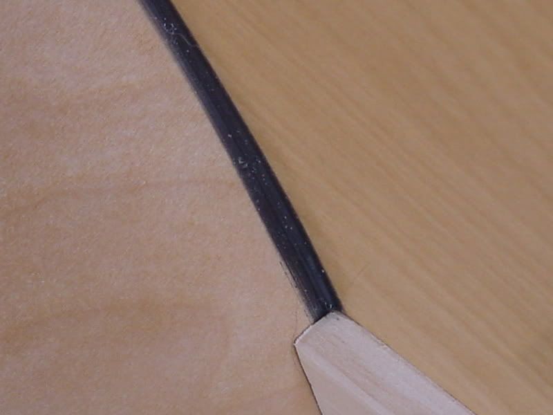

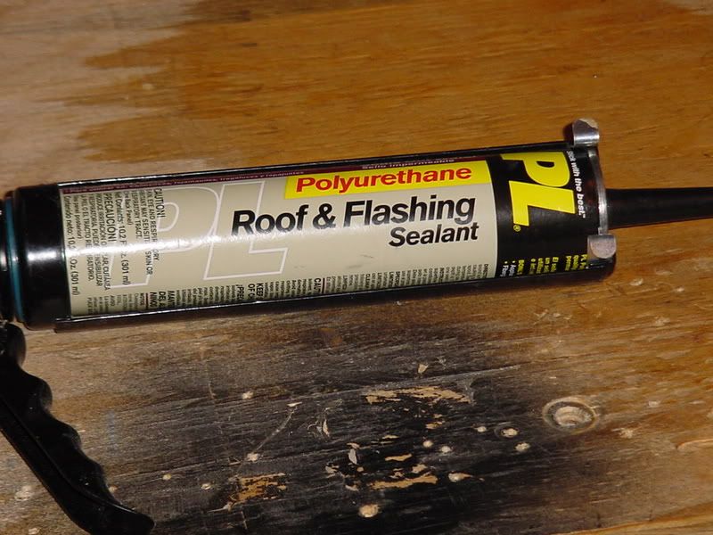

I did not put spacers between it and the sidewall, I put this stuff on it though. It is kinda cool, it is flexible but has hardened and water proof to keep it dry in between.

That PL stuff is really good. I'm using NP on my gaps between the fenders and walls. Just about the same stuff. Flexible and durable.

...nice MK...takka piece of cardboard or scrap ply and hold(clamp) it against the fender and trace for your template profile...

Madjack, that idea popped into my head on the way home from work. Now, off to find some cardboard :twisted:
