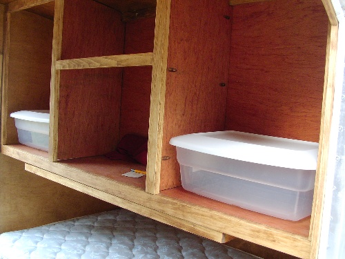

Postby BrwBier » Sun Jul 08, 2007 7:39 pm
These are the plastic boxes I bought to put shoes in at night. Then I made the cabinets to fit the boxes.
A shelf will go above the box and I still need to make the doors.
Brwbier

arent you afraid
Postby Jeeper92 » Tue Aug 07, 2007 7:26 am
that teh boxes will fly out while you are driving and hit a bump
Jeeper92
Posts: 529
Joined: Thu May 17, 2007 8:03 pm
Postby BrwBier » Tue Aug 07, 2007 7:44 am
you missed the line that says I am making doors for the cabinets
