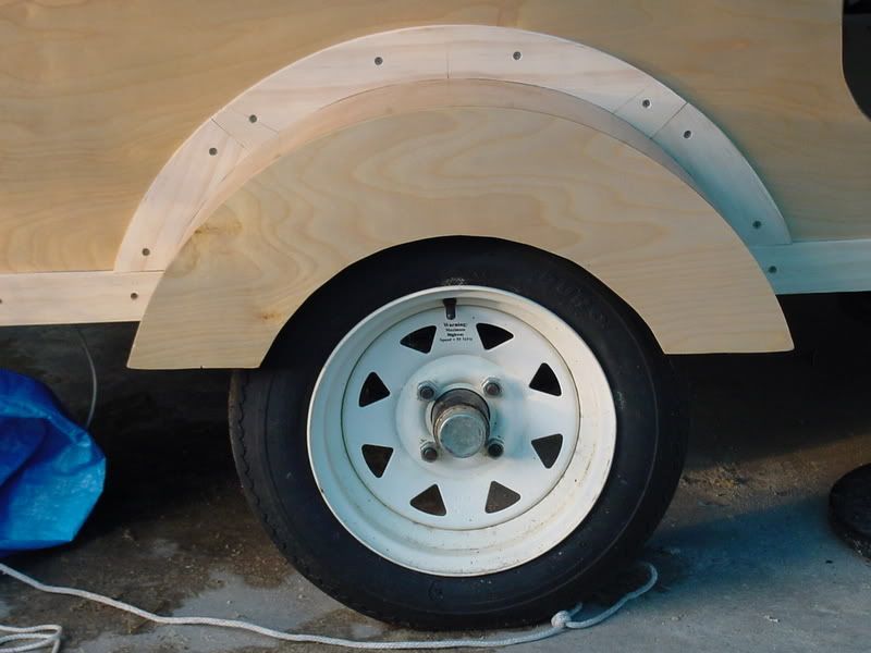

Well, I suffered through it and completed the trim around one fender.
Don't mind the pencil marks, I have to do some sanding. I will need to fill some little gaps too... :thinking:
One side of the the trim is done!!! :applause: One more to go.

Wow, Mary K, you are stealing my stuff. Wooden fenders with curved wooden molding.......what a concept. I would like to know how you fastened the fenders to the tear and also, what are you going to waterproof the underside with?
I was told that my 1/8" fenders wouldn't hold up, someone might sit on it. In answer to that, I hop up on the rear part of the fender and jump up and down on it, explaining that I think it passes the "Jump Test". (Little do they know that there is a welded steel license plate bracket below the fender, in that very spot where I perform my antics.)
I probably have 50 glue blocks under each fender, securing the inner and outer verticals. It is shot with Line-X truck bed liner to waterproof it. Don't pay any attention to the pencil mark comments, my work usually looks like a doodle scratchpad before I am finished.

As you can see I made some beefy fenders. 3/4" ply and skinned with luan and then 1/8" Birch.
I fastened with 3 bolts and big washers.

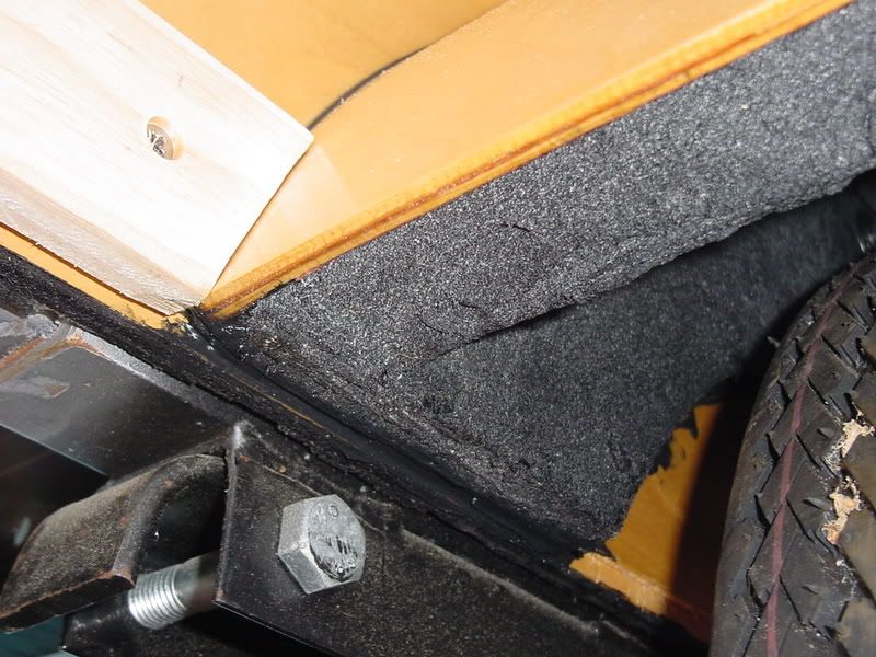

I used this stuff to seal between the side wall and fender.
I did a test piece of the PL sealant and I can NOT get the 2 pieces of wood apart. So That fender is not going anywhere.
Here is an odd angle looking at the underside of the fender.
I coated the fender using the really THICK roofing goop (technical term) I bought by mistake when I did the floor.
