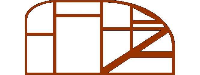

I have been looking at the various methods that have been used to build T&TTT, and I am wondering if anyone has built or knows of a design where a 3/4" or so ply is used for the sides, but it is weight relieved, insulated and skinned? So the "framing" of the side is made of a single hollowed sheet of ply, like this:
Is this a dumb idea?

Postby rbeemer » Wed Aug 01, 2007 11:04 am
Yep that has been done and nope it is not a dumb idea because it can make construction easier

Postby angib » Wed Aug 01, 2007 11:27 am
Unless you want it there for some other reason, there is no need to have that big diagonal - the ply itself provides as much shear strength as you can possibly need - this isn't a house.....

Postby Cliffmeister2000 » Wed Aug 01, 2007 11:54 am
Andrew says:
Good point, Andrew. I do have a tendency to over engineer.

Postby ssrjim » Wed Aug 01, 2007 7:34 pm
Cliffmeister2000 wrote:I have been looking at the various methods that have been used to build T&TTT, and I am wondering if anyone has built or knows of a design where a 3/4" or so ply is used for the sides, but it is weight relieved, insulated and skinned? So the "framing" of the side is made of a single hollowed sheet of ply, like this:
Cliff
The only issue I see is a lot of waste and extra cost. :thinking:

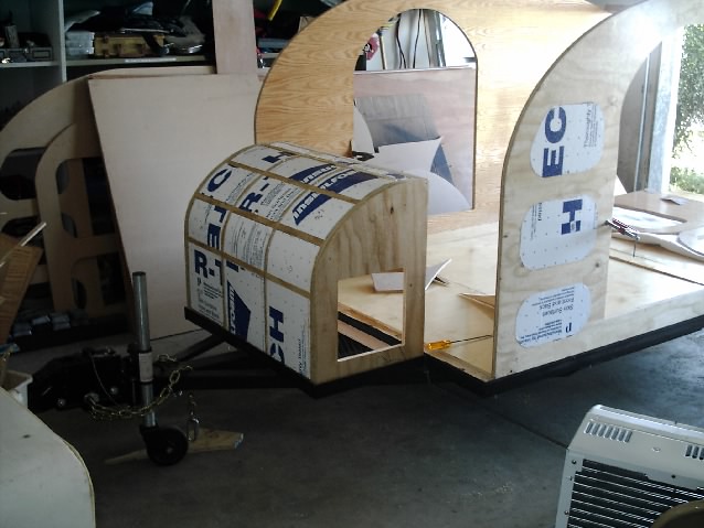

Postby john » Wed Aug 01, 2007 8:15 pm
Here's what I came up with. I would have removed more in the rear but I didn't know just how I was going to lay the galley out.
And with insulation

Postby dhazard » Wed Aug 01, 2007 8:22 pm
Like this...

Postby Cliffmeister2000 » Wed Aug 01, 2007 10:47 pm
ssrjim says:
Although there would be a lot of waste, not appreciably more than using solid plywood sides. They would probably still have to be skinned on the inside at least. Besides, the real reason is my lack of confidence in keeping the sides straight with thin plywood and a pine frame. By using this method, I am virually guaranteed a nice, smooth sidewall. As far as cost, relatively minor increase over using thin ply and pine, unless I used furring strips and hand selected them for straightness.
I have done some more drawing. I don't want to upload them, because the detail is lost at 640 x 480, so please follow my link. This design will allow me to put a 10 foot Weekender on an 8 foot trailer. Thanks, Mike, for the weekender design, and Joanne, for the great ideas from your build!

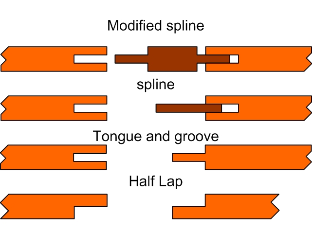

To make this weekender, is going to require 2 sheets of 4 x 10 plywood. I can think of 3 jointing techniques:
1/2 lap, tongue and groove, and spline. With spline, I have been playing with different ways to do that, too.
Any good or bad experiences with any of these? I have never tried to lengthen a sheet of ply before.
