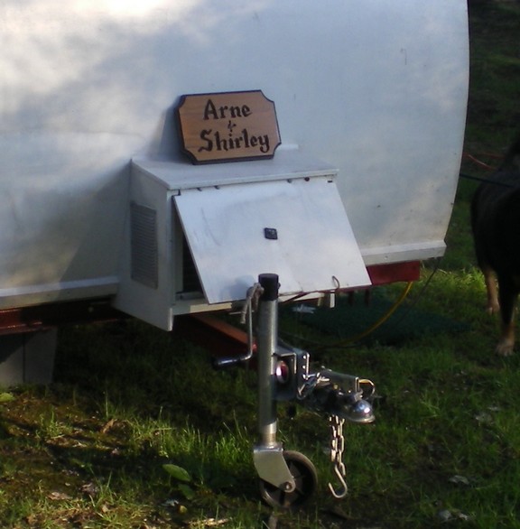

I think that is exactly what is happening... If you look at the second pic on my site, you will see the inlets on the side... the front door is closed, but it opens when camped, so air is drawn in the side and blown out the front..
If you do not segregate the airflow, you will get exactly what you have, a recirculation of hot air....
As mentioned the air is drawn in the side vents and exits out the front (the front is hinged and opens when I camp)... if I can find a better pic, will post it.

here is a pic with the door open.. I'm only posting it because it took me 4 tries to get it right.....

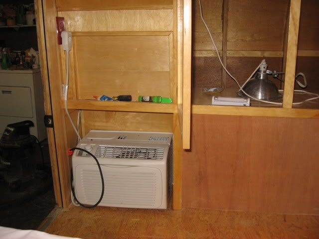

John I just finished mine and it works fine. You need to separate the side vents from the back with something. I used plywood and it works in a small space. You might need some kind of power vent to assist the air out the bottom. Here is mine. The holes are 3" each so I can use threaded drain pipe thingys with screw in caps to keep the critters out when not in use.
The unit sits back in the ply frame and has a small piece of sticky insulating strip on the air conditioner to keep the heat out.
Some extra hints. I put a thick layer of marine epoxy on the floor and up the walls. You need a drain tupe and some screen or the wasps will invade. ;)

Miriam C. wrote:Image
Is this the finished setup? It looks like it will suck the cold air back in thru the condenser coils and exhaust it out the back.

Postby john » Mon Sep 17, 2007 2:34 pm
I wonder if this is maybe a good thing.
Bringing air in from out side would go some way toward solving the problem of our over sized A/C units.
It would bring in O2 in the cabin and lastly, the "outside" intake vents would not be recirculating hot exhaust air across the condenser.
This may be a trifecta. :thinking: :lol: :lol: :thinking:
