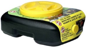

Postby prohandyman » Sun Dec 16, 2007 5:34 am
Nik
I was thinking of something like this. It's an automotive drain pan.
Might be adaptable :thinking:
Dan
