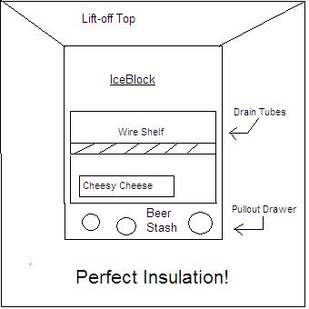

I was thinking about building a super-insulated icebox, and letting the drip-water drain into a pan under the icebox. This icebox will be for my dry food (cheese, lettuce, fruit, eggs, etc) that I don’t want waterlogged. :( Anyway, in that drip pan I was going to store some 12-oz cans and cool them with the drip-water. The lift-off top is for adding an ice block. I was going to have a front door to gain access to my cheesy-cheese and beer.

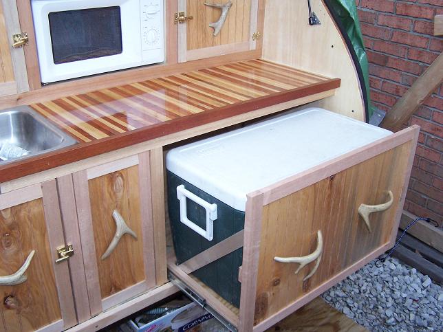

Postby prohandyman » Thu Jan 10, 2008 2:16 pm
Is that like the theory of relativity, or something? :lol: :lol:
Anyway, I am going to insulate the cabinet area inside of which the cooler slides into, thus providing a cooler climate for the cooler!

Postby prohandyman » Thu Jan 10, 2008 7:51 pm
Kevin or someone did a cooler test a while back, and several people agreed that covering the cooler with a reflective sheet insulation helped the cooler. And as side the cabinet I might also cover the cooler, I thought that if I coat the "chamber" the cooler resides in would also help. One person even coated the inside of the cooler with the same material (Refletex I think)

Postby Hillbilly Gene » Thu Jan 10, 2008 8:57 pm
:lol: :lol: Yep…..I’ll have to admit that maybe that math was a little over the top. :D 8)
But it you hadn’t gotten too glassy-eyed by the end, you’ll see that it allowed me to come to a sound decision, which was NOT to build in a beer-stash tray. Time well spent.

BTW. Cool Cold Cooler in your teardrop! Is that Ice Cubes melting in your sink? 8)
eamarquardt wrote:I would install a drain with a trap, route the tube under the tear, buy a cheap cooler that will hold a six pack and slide under the tear, drill a hole in the top of the cooler and let the cold water flow into the cooler to precool the beer (other liquids may or may not require the same treatment as a persons beer).
Thanks for the suggestion. I don’t want to waste that drip-water if I can capture it. Rather than dilute my beer, I can dilute that clear stuff that’s in quart jars. You know, that moonbeam... or something like that. :whistle::picklejuice:
