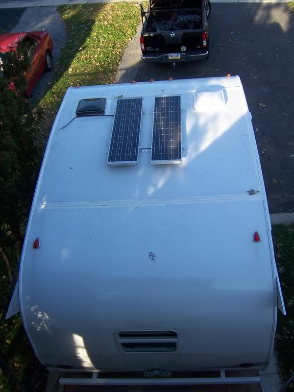

I use this stuff;
I really like it, its available at any RV dealer. Its called a "insert molding" outside corner. Its a little salty ($40-50 for a 16' length) But it looks great, bends easy and if done right (as long as the rubber laps over the edge, and a putty tape is used) it won't leak.
