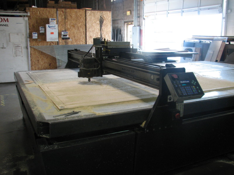

You could use one of these!! ;) :lol:
Jeff,
Thought you would like my idea of the router, hope you can figure it out with out using one, check out my album I have some new pics of my trailer with the epoxy and doors.
Have a great day,
Mike
