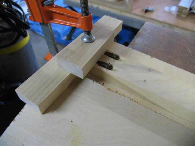

Postby bdosborn » Tue Jul 29, 2008 6:57 pm
kiltedwon wrote:Yeah, I actually was using the finer screws on account of the hardwood and using the clamp as instructed. I even tested on some scrap smaller pieces, but in the end I think I'll opt to drill pilot holes for any hardwoods.
Hmm, did you try it like this?
This way holds the two pieces in position as well as cutting down on splitting. :thumbsup: This wasn't in my Kreg instructions. You might still need pilot holes but this way has worked well with maple and red oak.
