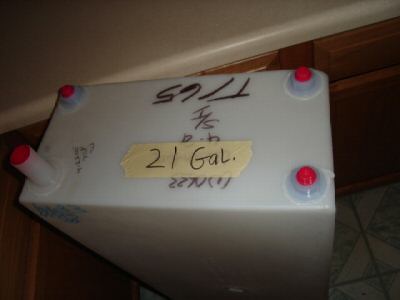

I bought a 21 gal polyethelene tank with 3 threaded 3/8" connections and one 1 1/4" hose fill barb to attach a 1 1/4" hose. The tank has no fittings and I would like to mount the tank flat and be able to fill the tank as well as pull water out of the tank to a faucet several feet away, as well as drain the tank. I need suggestions for all parts. I am building a 5 x 8 teardrop and want to be able to have faucet in galley area and be able to pump the water out of the tank to the faucet.

Sherry, you might want to make a drawing to show the location of the threaded connections and the hose barb. Without knowing the locations it is impossible to give any useful advice.

When you lay the new water tank on it's side have the 1 1/4" and one of the 3/8" at the top and side. Big for the fill and the small one for the vent. At the bottom will be the 3/8" outlet. JC Whitney sells a little 12 volt pump and faucet combo with the switch built onto the faucet. Sometimes you can find them on Ebay. plumbing is simple parts at home depot or lowes. Hope that helps!

Sherry you need to close the image tags for it to appear.

Not sure why your image doesn't show, but if you compare this one to your first post that should help figure it out. You had the close tag on the image though?
