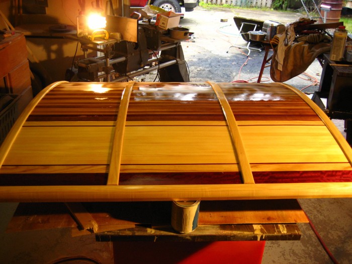

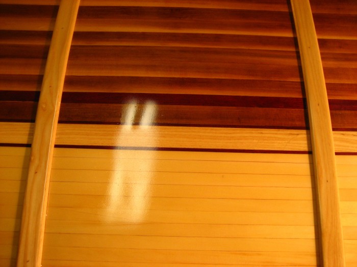

Life is a journey and one of the things I've wanted to do is learn how to paint with a HPLV. Fenders turned out well...but the doggone hatch has issues with clear coat...
On the first coat..I sprayed too dry...not enough paint and too much air...
Next coat...too much paint and too little air...eerrrg sags...
And on it goes (hats off to the guys who really know how to do this)...
You can see the orange peel and sags...what's my next step...
Sand and recoat or buff and polish???

JD, the only way to get rid of the sags and orange peel is to sand and repaint...all I can say is damnitman and practice, practice, practice......

JD , orange peel can be buffed out with some aggressive rubbing compound & a good random orbit polisher. My son's car had it when we repainted it & he spent the time do some wet sanding then buff it with compound , then polished it with a polishing compound after he had it smooth. The sags will have to be sanded out then maybe touched up with another clear coat. Good luck! :thumbsup: :thumbsup:

What they said... wetsand... Like you, I need some practice shooting, but watching my dad paint a few cars in the day, I learned the sanding part. ha ha. I used a wet sand paper, and a small thin rubber block squigee (sp) as a backer. After wet sanding an area down, I then used the rubber squigee to pull the water away from the surface. A quick look across the surface will reveal any imperfections. Repeat as necessary, then polish.

Dave...the sanding is a lot easier if you do it in the first 72 hours or so. After that, it becomes much more difficult. For me, usually the first coat is only a tack coat. Just get some material on to cover it, don't worry about orange peel or gloss, let it flash off a bit, then put on the next couple of coats, letting it flash off in between, just a couple of minutes. The next coats will melt into the first ones. I think a person is better off trying to do several coats of lighter sprays than a heavier one.

I'm on it and yea...so far, I've painted a burn barrel and a set of fenders!!! That clear is hard stuff to sand (even at 24 hours) but I have pretty much got it down to 600 grit so far. Even at 600, it looks alot better. I think my mistake was too dry on the first coat and I never recovered being a "painter want to be". I'm optomistic that I'm going to be ok on my next try. We'll see!!! If this don't work, I'm flying you up, or moving to spar varnish!!!!

I don't think you'd need to go to 600 on the sags. The clear can cover a 320 scratch. It might be wise to contact your paint supplier and check with them to see how long it needs to cure prior to a recoat. If done early, you can just spray...if it goes too long, it needs to have an entire scuff on it, then shoot it. At least that's what they tell me on the Transtar Euroclear. Others opinions may differ. Doug

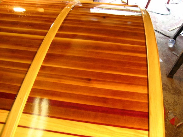

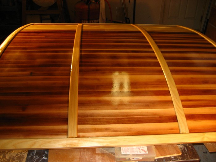

Well, try number 2 went better than try number 1...then I ran out of clear!!!!
No sags...but a bit dry...I'm a thinking it is close enough for rubbing compund, polishing compound and of course...wax on..wax off...grasshopper!!!! Shucks...by the time I get this done... Earl Schieb is going to be looking good!!! It has been entertaining though!!!
Juneaudave
Posts: 3237
Images: 380
Location: Juneau, Alaska
Postby doug hodder » Sun Oct 05, 2008 6:04 pm
That looks great Dave!!!....give it a while and then look to see if you want to do any polish on it. I wouldn't bother...if anyone gives you heat on it, poke them in the eye and when it's all watery...ask them how it looks now!!! :lol: I'm sure most will agree it looks great! It will change some as it cures and all the solvents evaporate....but considering your experience...you ought to be very happy. Yup...running out of material is a drag, been there, done that! and your material is a lot better than Earls. Everyone is going to be so wowed by your trailer that they will never notice any dry or orange peely areas. I give it..... :thumbsup: :thumbsup: :thumbsup: :thumbsup: :thumbsup: Doug
