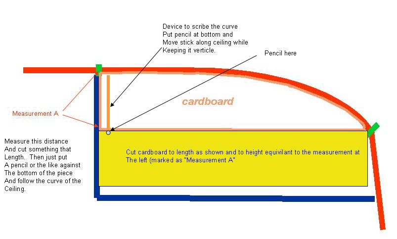

Postby CrocTears » Tue Oct 14, 2008 11:02 am
Whack me with a cast iron pan, I still don't get it.
Ok, if the red is the ceiling curve and I need to match it between the green points, how can I hold something up there and just trace it to get the curve? I don't see how a square cut anything would physically fit up there to trace onto??
I thought I'd have to build a front template like this, then cut.

Postby bobhenry » Tue Oct 14, 2008 12:48 pm
oh my ......
I was seeing a nice gentle side to side curve about a 12 ' radius sorry for the confusion..
Yep ! get out the cardboard to get close !
Postby toypusher » Tue Oct 14, 2008 1:19 pm
Maybe this will help.
toypusher
Posts: 43040
Images: 324
Location: York, PA Area
Postby CrocTears » Tue Oct 14, 2008 2:25 pm
Toypusher! That's genius! I'd kiss 'ya!
