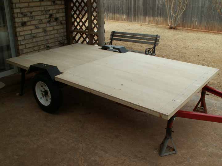

Postby Toytaco2 » Fri Nov 14, 2008 7:50 pm
I went 5 wide on my HF frame. Its really unusual because I went 5 high as well. Just build the floor out over the top of the wheels and build in wheel wells.
Here's the floor before anything else what done (I later removed the fenders):
and here's what the wheel wells look like:
More pictures in my album of the floor and frame.
