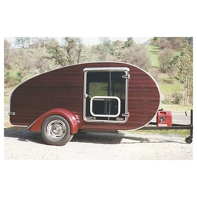

Postby grant whipp » Wed Feb 04, 2009 2:42 am
Yup ...
... radius-corner baggage-door frame, 1/8" Lexan® "core" held in the frame by shower-door welting, 14x21 radius-corner slider window cut in & mounted in the lower half, chrome paddle-type hinges from Featherlite, locking storm door latch & handle. My cost (in 1996): over $300.00! Warning! If you want a door like this to live a long life, treat it with some respect and be gentle with it ... don't go slamming it around and expect it to hold up for very long. This one is still on the road and functioning O.K., even though suffering from some abuse.
Good Luck, and ...
CHEERS!
Grant

Postby Mike M. » Wed Feb 04, 2009 8:13 am
Grant, once again your work amazes me. Thats exactly what I want. You are my hero. now that price, back in the day, $300 for one door or two?Doesnt matter, Thats what mine will have.. :twisted:

Postby grant whipp » Wed Feb 04, 2009 1:25 pm
One door, Mike!
