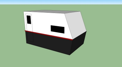

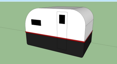

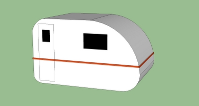

I've recently acquired a trailer and am going to build a light standie similar to the original puffin.
I have been thinking about 2 different designs and would like some input.
which of the following do you like the best? I'm thinking that the squared off one would be easier to build but I'm not sure.
Also, do you think that a rounded trailer would be more structurally sound?

Postby Miriam C. » Mon Feb 23, 2009 10:15 pm
Well Marty, either will be as strong as your joints, glue and screws. My only issue with the square builds are getting those angled edges together in a way that will not leak some day soon.
Postby tinksdad » Mon Feb 23, 2009 10:21 pm
It's just my two cents worth; but I'm partial to curves. 8)

Postby martydukes » Mon Feb 23, 2009 10:23 pm
I'm leaning toward the curved one myself after looking at them for a while..
do you think it is possible to bend ply around corners like this?

Postby Wimperdink » Tue Feb 24, 2009 12:08 am
likes and dislikes aside, I would suspect the rounded profile would be less apt to experience roof sagging later on.
