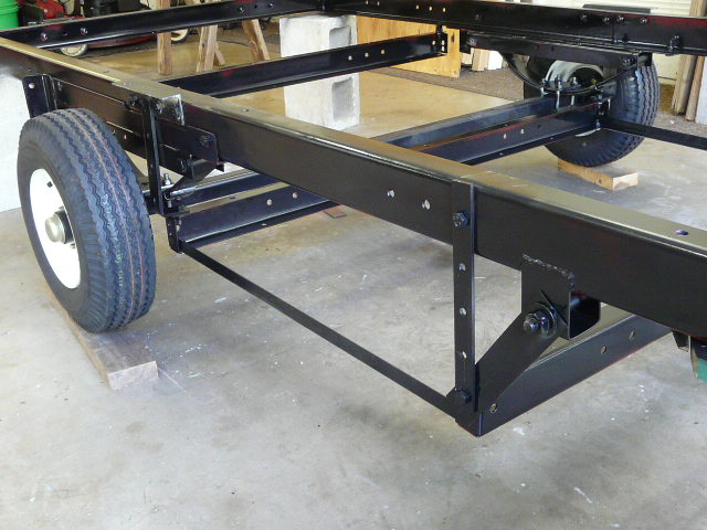

Week 1: With any luck, this shows the original flat trailer turned into a tiny travel trailer frame, showing the drop floor. I was able to use only original trailer holes and all scrap straps but did have to drill two of those. The key strap is a stout piece from an old boat trailer and neatly clears the front of the tire and the spring bottom and side. I painted it for two reasons: the metal bits were ugly, several different colors, and by the time I was done, I'd had enough of Chinese red![/img]

Interesting drop floor. Right now there is little if any load on the tires and springs plus the tires are 1 3/4" off the floor. How much ground clearance will you have at the front of the drop floor going thru dips and over speed bumps once the trailer is built and loaded?

Postby Barefoot » Sat Mar 14, 2009 5:55 am
Miriam, thanks for the tip. I realized that maybe I should have copied the URL of my photo and not the one used in the example, but by then was about seven miles out in the woods! Now I wonder how the picture got included after all. I've made some progress since then and will try another photo later today. So much to learn after glue-and-screw and drill-and-bolt. Wait until I have to learn to sew!
Frog, the clearance will be six inches, the same as the tow car, and the bottom of the coupler hits first, at least on paper. If the springs settle more than I expect, thin blocks between the springs and axle should fix it.
I failed to point out the reinforcement across the joint in the frame and that the next-to-last crossmember is spaced down a little , yielding a two-step drop. Yes, I missed a couple of spots, painting. Drat.

Postby kirkman » Sat Mar 14, 2009 7:50 am
Looks good! :thumbsup: But I think 6" might be cutting it kind of close I think 8" would be better. That's just my opinion. 6" might work but I would hate for you to get all done and fully loaded to discover you now have only 4" and it is hitting every thing you drive over. That would really ruin your day. :cry: Good luck cant wait to see you build progress! :D

Postby Frog » Sat Mar 14, 2009 1:13 pm
One way to ensure clearance would be to go with taller tires assuming they will clear the fenders plus a similar rise in the the ball height on the tow vehicle. IMO it might be something to consider before buying and installing fenders.
Installing even a 1" block between the springs and axle would probably only result in a 1/3" - 1/2" rise at the drop floor due to the relationship of the distance between the axle and the drop floor and the drop floor and the tongue. You still might have to increase the height of the ball the same amount.
Just my thoughts on the matter for whatever little they are worth. Looking forward to the rest of the construction.

Postby Barefoot » Sat Mar 14, 2009 6:10 pm
Kirkman and Frog, thanks for leaning on my thinking some more, until I had an Aha moment. I already have on hand one like new 5.70-8 tire on a 4-bolt wheel, one more of which plus mounting would gain an inch, all I can and still get it inside, and the same as buying a pair of 4.80-10 tire$ and wheel$ Deal!
Today I did not get to work on it any after all, so will not have to tear the inner fenders back out to raise them, and can keep one of the current 4.80s as a spare --and there's still the axile block if need be. Besides I never liked the idea of those teensy wheels whirring maniacally at [mumbly-mumbly] mph.

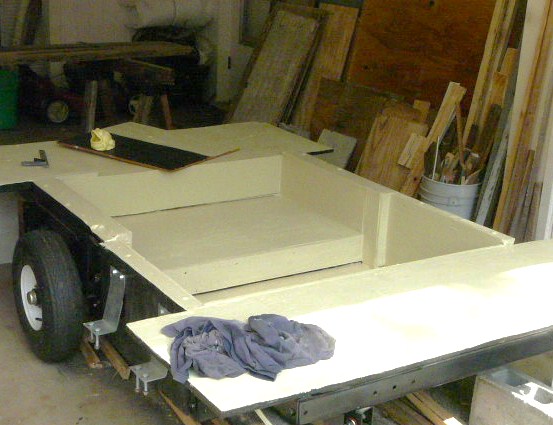

Towed Hall, Week 2: The floors are in, the foot wells boxed in, and all is painted inside and out. For years I've done sloppy joints (first message) and just found that my small square (aft) is small but hardly square. Since I'm also learning to saw straight, we'll see if things improve.
Fortunately, any problems with, uh, recycled plywood (to right) and small lumber (below), and um, emerging carpentry skills respond to putty, caulk, and foam. Note that the thin gaps at the floor are for tucking in carpet without needing trim, and are closed off.
Alas, in this small town, the closest I could get to a 5.70-8 tire was zip, and it turns out there are actually two diameters so numbered, so it must be a tape-measured sale. I'll try Daytona after spring break.

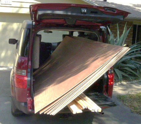

One home supply store in the whole county finally got in some door skins and I rushed over before they were gone, but need not have. They are fiber (cardboard), so my choice was 5.2mm luan or 5.2mm luan, so I got 5.2 etc. I do have on hand two door skins and one similar size piece of very flimsy 1/4", so if I use the flexible plastic cieling I saw, I should be OK. Next time I ought to know to fetch plywood before tearing the lights and fenders off the HF trailer! Of course I had expected to bring home 3x7 sheets. Besides, who says a Honda Element won't take 4x8 sheets?
