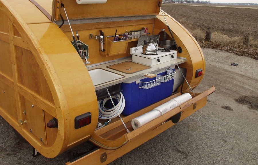

Postby Von Pook » Sun Mar 15, 2009 9:40 pm
What if, for the pantry opening, a "clam shell" style hatch set up? In other words, a lower hatch door, and an upper hatch door. The hatch doors would seperate about mid height of the trailer, allowing the lower to swing down, and the upper to travel up. It would require an extra latch system to hold the lower in place while in transit, but might allow for more use of pantry area. Thank you for your time

Postby Miriam C. » Sun Mar 15, 2009 10:17 pm
:thumbsup: :applause: It works! The one I remember best is Gern B's.

Postby Boodro » Mon Mar 16, 2009 10:08 am
Checkout my album. I have what you describe. My hatch used to be full size , but I did a rebuild & found that this works very well. The bottom hatch has a strap on each side so it does not fall & hit my bumper. But like you said it does take 2 latch systems. I did them the same way . Good luck! :thumbsup: :thumbsup:

Postby Von Pook » Mon Oct 12, 2009 1:44 pm
The "clam shell" pantry hatch system, works like a charm. Thank you for your help in thinking this through, Eric Image The lower hatch works well as a mini bar when in the closed position also :beer:
