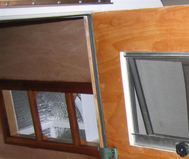

Mark, most folks probably do something like what is shown in the Generic BenRoy plans, which uses "T" molding applied around the door...the weatherstrip is placed on this and it seals against the wall(outside sealing)
We do it differently, we take two pieces of 1x1/16th Al angle, rip one leg(on both pieces) down to 1/4" and put the two long sides against each other to form a "Z"...the outer piece wraps around the door opening with the 1/4" lip capturing the side...the inner piece has the lip to the inside and the seal goes on this...we use TrimSeal for this seal and it provides a seal on the inside...we place the inner piece of 1x1/4" on first and the outer piece goes on over this...the door itself is either totally epoxied or a piece of 3/4" Al channel is wrapped around the door...once again, the legs(both of them) are ripped down to 1/4"...of course we build with 3/4" ply walls/doors, which allows us to do it thisaway..it is a good bit more work to doit this way but we like the nice clean finish you end up with...I believe Doug Hodder and Steve Frederick do something similar but use wood for the inner sealing flange...there should be a few pics in my personal album and there are more under my WWW button....
madjack 8)

Postby greekspeedoman » Sun Mar 22, 2009 10:08 am
Thanks Madjack,
That was exactly what I needed. Your description was perfect & your pictures exactly what I had in mind but couldn't picture there. Thanks! I think I'll do a variation of your design (my doors are insulated because it is the NW and not the south). Thank-you so much.
jplock, Thanks for the advice on the doors. My doors are square also (and now I wish they weren't). Do you think a piece of flat aluminum on the top to seal that would help the standing water issue you got?

Postby madjack » Sun Mar 22, 2009 11:38 am
Mark, JP...you can get a "rain diverter" to put above the door which will eliminate the water getting on top of the door...these are available from Grant at Lil Bear or most RV/mobile home supply places...you can see one above my window in the pic but they make them big enough to go across the top of the door...Grant also sells a "J" molding for the same useage
