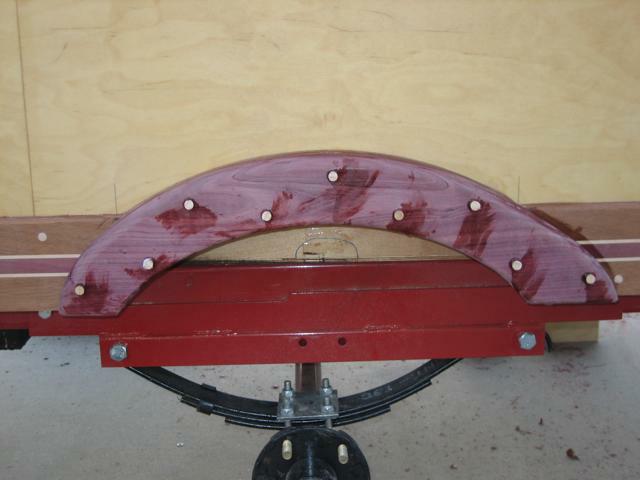

I'm building a 5 footer over a HF 4 foot wide trailer. That put my side walls right about the center line of the tire. You can see how I am dealing with it.
The "fender" is built up of 4/4 mahogany, covered with 4/4 purpleheart and maple plugs for the screw holes.
