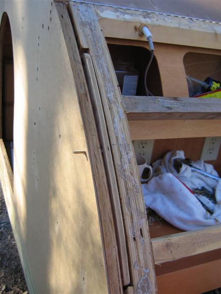

Bending Plywood! - Never done it before until my fourth build :thumbsup:

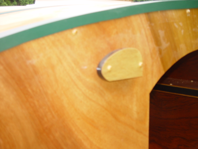

I'd have to say the fact we have no Door knobs, and also alittle different porch light.........glows off wall.

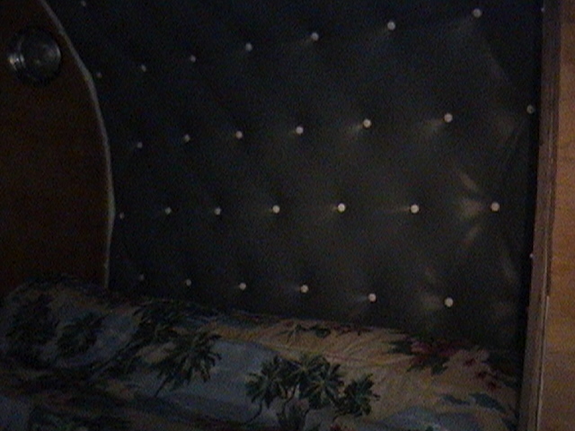

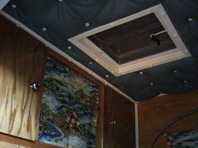

I would have to say the new headliner I just finished installing, originally I used panelling and I never really liked it, so I covered it with foam and vinyl and an amount of buttons I haven't counted yet.
Now I'm wondering since I have leftover vinyl and foam, do I redo my cabinet doors, with diamond tuck vinyl inserts?

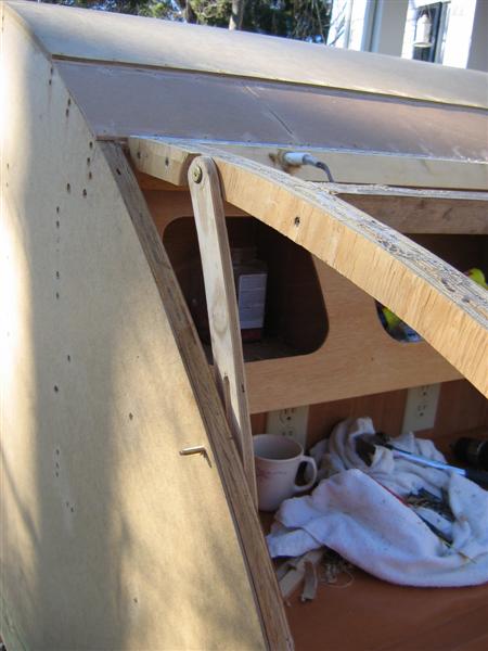

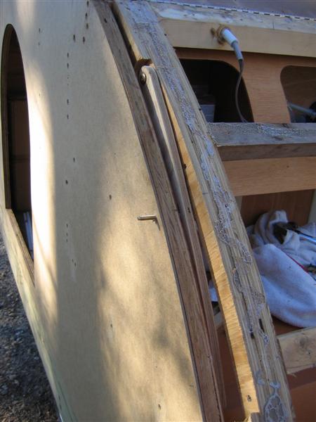

I like the hatch props on my first build.
I had painted myself into a corner with the curve of the galley cabinets on the right side of the galley. I had very little space left to install the props and the space I had forced the props to be curved.
I had to build two sets due to the first being too weak. The second set was laminated together with three layers of 1/4" with left over aluminum skin sandwiched between to increase strength. They lock, fold, and work well. I'm proud of them.
Sorry for all the pics but it's a motion thing I am trying to capture plus like I said....I am proud. These are pics of the first set of struts that were too weak. The last pic shows the lack of room on the right side of the galley.
