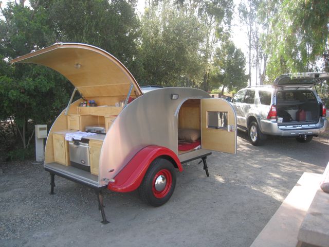

Postby Dean_A » Tue May 26, 2009 1:55 pm
I used starwheel-type supports. They're rock solid and were easy to install. Plus lifting the hatch manually makes up for all those times I don't go to the gym. :lol:

Postby Creamcracker » Tue May 26, 2009 2:58 pm
Dean_A wrote:I used starwheel-type supports. They're rock solid and were easy to install. Plus lifting the hatch manually makes up for all those times I don't go to the gym. :lol:
Hey, Dean...where did you get those from...they look like the ones in the MGB catalog (Hood props) ...do you have a different source?

Postby Dean_A » Tue May 26, 2009 3:36 pm
Philip
I got them from Austin Hardware back before they... changed.:roll:
I got them for $9 each. They are now listing them for $29 each :shock:
I've heard that if you call them instead of ordering online you can get a better price, but I have no first hand experience.
I also found them here with a google search for "telescopic door props". The price is more inline with what I paid.
http://www.eztruckaccessories.com/teles ... d-prop.asp
FYI, I cut mine down a bit shorter and removed one of the brackets to fit my application better.
