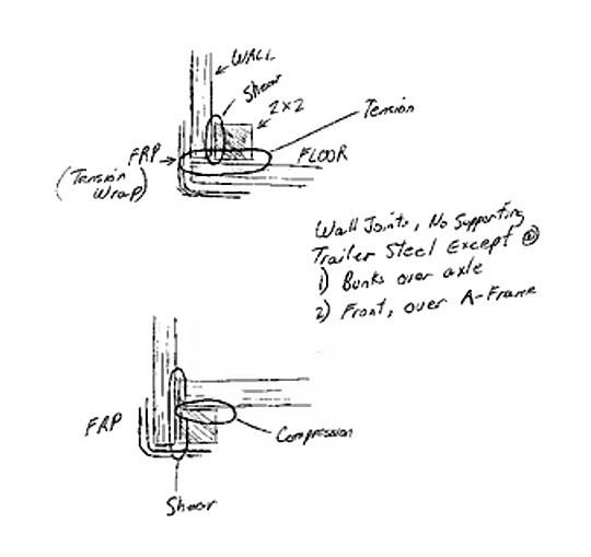

I was going to glue a full-perimeter 2x2 cleat around the perimeter of the floor (3/8" from the edge of the floor) to tie the wall to the top of the floor. When thinking about reactions at the rear 2' of the trailer, where there is no supporting steel trailer frame, I became concerned that reactions would put that rear perimeter of the floor in tension, thereby trying to lift the top veneer off. I figured I'd run deck screws up from under the plywood floor and into the 2x2 but still, glue would be the main structural connector, at least in my assumptions. I'm not so concerned at the front of the trailer since the A-frame provides support/punch, as does the 2' bunks (atop the axle mounting point) on each side. I was a little concerned about the front corners but so much of the reaction would seem to be at the A-frame, didn't worry too much.
Then I figured that gluing the 2x2 perimeter cleats flush with the floor edge, overlapping the walls and gluing them to them would put things into shear or compression. I'll use deck screws regardless. That seemed an innately better design but loses me 2" overhead. We can live with it but if there was a silver bullet that would keep the 2, and address the delam forces, so much the better. Whatever I do will have FRP cloth sealing and supporting the exterior edges but I can make that strong or stronger.
That making sense?

Postby jmedclay » Wed Jul 01, 2009 8:00 am
[quote="kennyrayandersen"]how about a simple sketch?[/quote]
Can't see how to attach/insert an image, so I put a sketch here...
http://www.flickr.com/photos/21624415@N04/?saved=1
The top arrangement would need substantial FRP edging for strength but is sano, the bottom would get it for sealing purposes but wouldn't rely on the strength it offers. At least that's how I see it. The bottom detail seems the safe way to go. What do you think?

My opinion, I like the bottom version, don't have to deal with a cleat on the interior of the trailer. If you use an epoxy for an adhesive, I'd think you should be fine. I seal the ply edges with epoxy, no cloth and all have been holding together fine. Doug

Thanks Doug. I've decided to go with the bottom version. The lumber is on deck. I hope to have the floor framed up, and the walls shaped and well under way this weekend. Glue: I've read a lot of good info on Titebond II, so am planning to use that with deck screws. I'll probably end up glassing the entire box; top, bottom, sides - everything, to seal it up well for a long time

Of those 2 I also like the bottom one as well, but either of those I think will be heavier than the sketch I drew (mind you it’s probably only the weight of the cleat – maybe 10-15 Lb). That concept does make it easier to install through-bolts than the one I sketched. It also puts the joint between the wall and the floor in shear, which is what you want. I think as long as you seal the bottom really well you could leave off the wrap plies as well, but as long as you are wrapping the whole thing… couldn’t hurt. Just remember to put some king of radius on the corner so you won’t break the plies and make it a bit more robust with regard to impact damage.

:o Seems to me with the bottom picture the weight of the wall is supported by the cleat and nothing else. If you reverse that, and put the cleat on the top but hang the wall over the floor you will only loose the thickness of the floor but still have a cleat to screw into. The cleat and the floor are supporting. May not matter---but you will loose less of your height that way.
You can still come from under and screw in with deck screws.

And thanks for the input - I appreciate the ideas. I ended up choosing the second of the two since the wall and front are supporting the floor, for the most part, particularly aft of the axle.

Even if you are going to do the floor/wall joint the way you say, I would still connect the floor to the side wall independent of the cleat. Maybe it’s not exactly necessary, but us stress guys like to see it not only light-weight, but robust. I would close out the floor with a perimeter 1x2 (2x2 at the front wall) and then I would glue and screw the side wall to the floor (with dowels or biscuits). That would be enough, but the cleat would be extra insurance and could be bolted every 12-18 inched with some ¼ inch dia bolts. That will leave you locked and loaded and FAR more robust than most commercial trailers are built (i.e. you’ll have your structural box).
