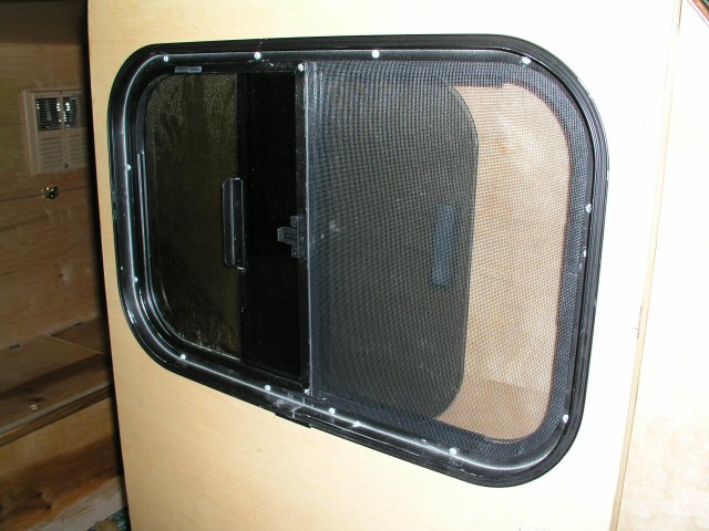

Postby larryl » Tue May 10, 2005 8:09 am
Have both doors mounted. They work and lock. Need to slightly adjust the alum. trim that is mounted on the doors to have a proper reveal shown next to the wall trim.
I installed black radius cornered windows from TJ Trailers. The space between the window and inside skin was covered with black vinyl baseboard. It's normally used on a wall after tile or sheetgoods are installed. I think it turned out nice.
I will be cutting out the inside trim piece from birch plywood to finish off the windows.
Larry

Postby bdosborn » Tue May 10, 2005 9:07 pm
larryl wrote:I installed black radius cornered windows from TJ Trailers. The space between the window and inside skin was covered with black vinyl baseboard. It's normally used on a wall after tile or sheetgoods are installed. I think it turned out nice.
Larry
Boy, I'd sure like to see a picture of that before I commit to the trim rings.

Postby mikeschn » Wed May 11, 2005 12:41 am
I've got that window. Steve put the trim ring on it too. I'll get a photo of it this afternoon!
Postby mikeschn » Sun May 15, 2005 5:14 am
Okay, I finally got that photo of the trim ring! :?
