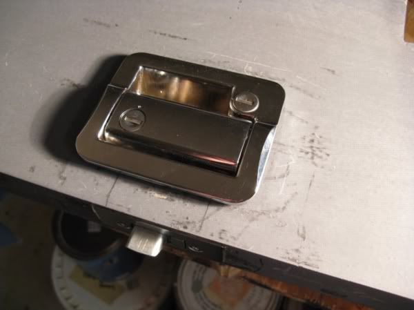

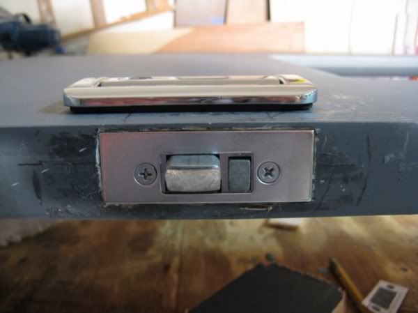

Postby bbarry » Sun Dec 20, 2009 7:46 pm
I used the L handle shown below:
with the lockset that has an interior thumb latch:
I don't have a good shot of them on up close. They worked out great for a 1" thick wall. Just a small shim plate on the inside behind the lock gave me the perfect "ker-thunk" close.
I think you can get them from any Red Neck Trailer location. I ordered mine from http://www.tjtrailers.com/store/door-accessories.html. If you use something like this, remember to get one right-hand lockset and one left hand. The handles are all the same.

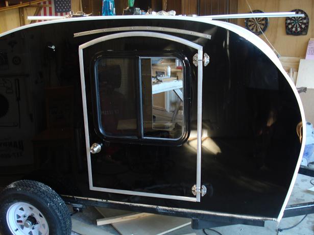

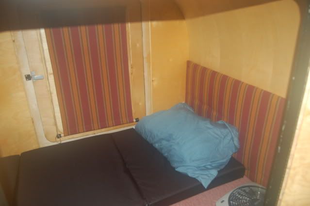

Postby Jst83 » Mon Dec 21, 2009 1:55 am
As Dan did I also went with the standard house door knob and have had no troubles with it. I'm planning on the same with my present build

Postby b.bodemer » Mon Dec 21, 2009 6:48 pm
Like Dan I went with a regular door set, just picked a different looking style knob. Easy to find two with the same code.
Used a cool tool to cut everything just right!
