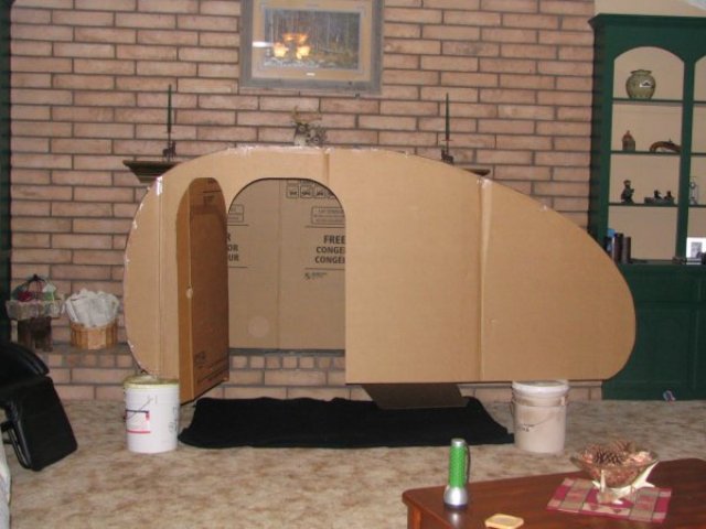

Postby Rickxr2 » Thu Feb 04, 2010 9:42 pm
I went the cardboard route. Went to Lowe's and got some refrigerator boxes before they crushed them.

Postby dh » Thu Feb 04, 2010 11:29 pm
Rickxr2 wrote:I went the cardboard route. Went to Lowe's and got some refrigerator boxes before they crushed them.
I love the fact that it's sitting on 5 gal buckets in the livingroom. You must have a very supportive whoman.

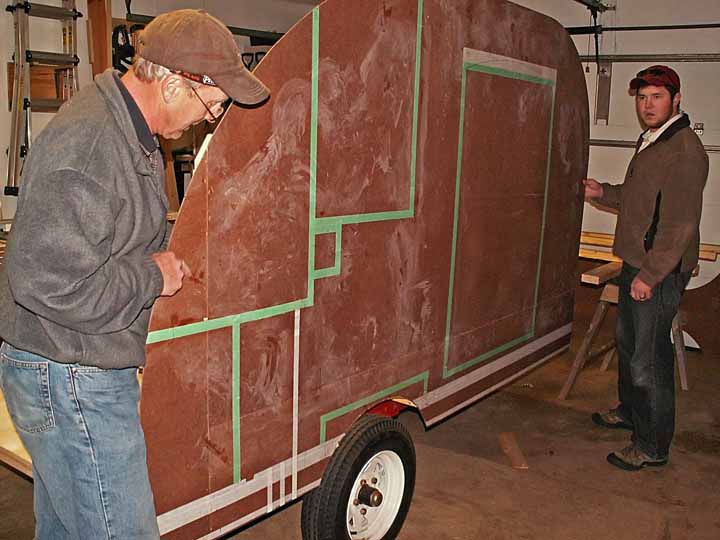

Postby Toytaco2 » Fri Feb 05, 2010 8:48 pm
As you can see, everyone has their own favorite way to do it. I used the masonite template method. I was able to tape off the cabinet, door, and other locations and use it as a pattern for constructing the wall framing before skinning with plywood (we used sandwich wall construction with foam insulation. I think I would do it this way again if/when I build #2.

Postby Senior Ninja » Fri Feb 05, 2010 9:01 pm
:applause: :applause: :applause: :applause: :applause: :applause: :applause: :applause:
Nicely done! Great planning. Probably would'a prevented problems I faced later.
