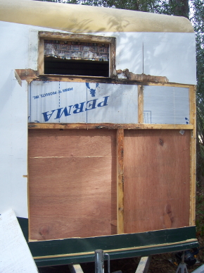

Here's a pic of some of the removed panel. The wood to the right of the window is also removed.

Postby starleen2 » Sat Feb 06, 2010 4:41 pm
Lynn Coleman wrote:To clarify it was put up with fiberglass the first time. I figured we would have to sand down to the wood. Does that mean we have to remove the fiberglass cloth that is on the other side to go down to the wood or will the new fiberglass simply adhere to the old glass?
Lynn
That depends on your panels - If they are thin, I'd say rough up the finish with some 80 grit and reapply over the old fiberglass. But ONLY if the epoxy has not cracked or delaminated from the existing ply - If it has then you might have to sand all the way to the wood. On any painted surfaces - the paint would need to sanded down to the epoxy layer removing traces of the old paint - Like Steve said
