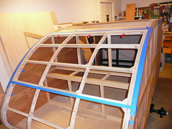

You may want to try to build it in place. This picture shows my hatch framing waiting to get its outside plywood skin. I used spacers and screwed through the sidewall to hold the framing in place. The blue tap is to keep the plywood from adhering to the sidewalls and upper spar.
You can't really see it in this photo, but I have a wicked curve at the bottom of the hatch, and so far I don't have any springback.

aggie79 wrote:You may want to try to build it in place. This picture shows my hatch framing waiting to get its outside plywood skin. I used spacers and screwed through the sidewall to hold the framing in place. The blue tap is to keep the plywood from adhering to the sidewalls and upper spar.
I also plan to build the hatch in place. What were your side and bottom gaps and what was your outside skin material? I see that you used plywood for the ribs. How wide are the ribs? Did you use pine for the cross braces? You did a beautiful job on your build. Thanks, Steve

ssample wrote:I also plan to build the hatch in place. What were your side and bottom gaps and what was your outside skin material? I see that you used plywood for the ribs. How wide are the ribs? Did you use pine for the cross braces? You did a beautiful job on your build. Thanks, Steve
Steve,
Thanks for the compliments. I used 1/4" spacers for the sides and the bottom and 3/8" spacer where the hurricane hinge will be. The outer ribs are doubled 3/4" plywood and the inner ribs are single 3/4" plywood. I used poplar for the cross braces. They are fastened with PL Premium and pocket screws (Kreg has the blue ceramic coated ones for weather resistance.) The ribs are only 1 1/2" deep. It seems pretty rigid and will get more so when the interior plywood is attached. That said, I would probably go with a deeper outer rib if I were to do it over again.
