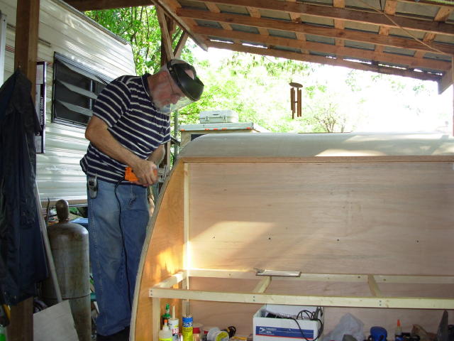

Mike, I used a cheap Sheet Metal Shear from Harbor Freight. Clamped my 'skin' panels in place on the TD & marked the profile. Used the shear to cut 'em a quarter inch or so larger then 'secured' 'em in place with construction adhesive (yeah, I know it'll separate from different temps between wood'n aluminum but it wuz only temporary 'til door'n edge trim installed) & a few staples/screws along edge. I then used a cheap (like that word cheap ;) ) trim router also from HF, to trim the skin edge flush with the wall profile. One tip, use the largest diameter 'flush trim bit' that your router will handle & if you don't have a variable speed trimmer, go SLOWLY...! The larger bits won't clog up as badly as the small 1/4" ones will. Also, I found that a single flute bit usually works better than a multi-flute bit. Again, go SLOW, else you'll spend a lot of time cleaning aluminum dross from the bit(s). Think I paid almost as much for the flush trim bit as I did the router :cry: but it wuz worth it in efficiency. Bought both the router & shear on sale & used %-off coupons, don't think I paid much over $20 for either in 2006.
