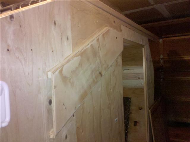

I will being using two 120mm computer fans for the exhaust in my TD.
They are native 12v are reversible as mentioned and there are a ton of speed controllers available for them since they are a computer thing :)
I chose to build a tunnel down the side to keep out rain and such. I will only have fans on one side and will build a tunnel on the other side for intake, with a filter to keep out bugs and such.

Postby dreadcptflint » Wed Mar 10, 2010 11:02 pm
MceeD,
I couldn't figure out what you did with the inside of your vents. Do you have some pictures that you could post from the inside? Are you able to seal it from the inside or do you just have the fans in place?
