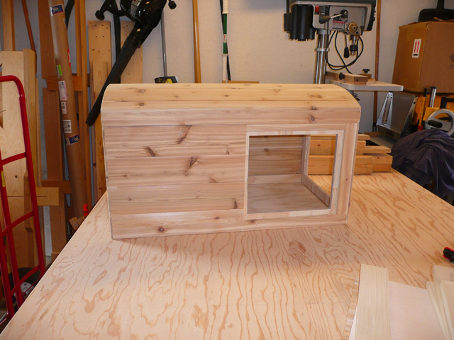

I am planning my tongue box for my TD. It will be wood construction. For anyone who has done this, how did you attach it to the trailer? I am thinking of just bolting it to the existing holes for the spare tire support, but am wondering if I need more then 1 bolt on each side to hold it down. My Tongue box will be used to store the battery, 4 stabilizer jacks and an extension cord.
Thanks for the help

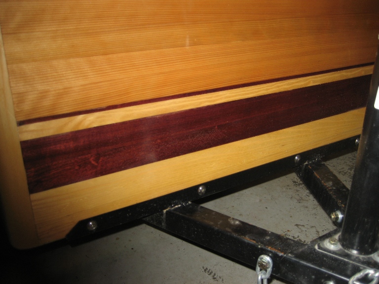

A great thread. I have 1720# HF trailer. I also added a tongue box. I started by building one out of excess plywood. It needed to hold my battery as well as some items like the jacks and a few tools and my water tank. I built the box and installed it to the frame using wood to metal screews. They hold very well and I am convinced I would have no problems. By the way I used these screws to fasten the deck to the trailer frame.
Now this is where I went wrong. I forgot to weigh my box loaded before I installed it. My hitch is restricted to 150# and when I weighed the tongue it was 170lbs. Even removing everything except the battery I was still at 150lbs. So I removed my homebrew box. I found a box at Wally World called a trunk box. I loaded up the box with the battery and a few of the necesary items and got it under 150 lbs. I fastened it to the frame with the same wood to metal screws.
Actally I like this install better than the homemade box.

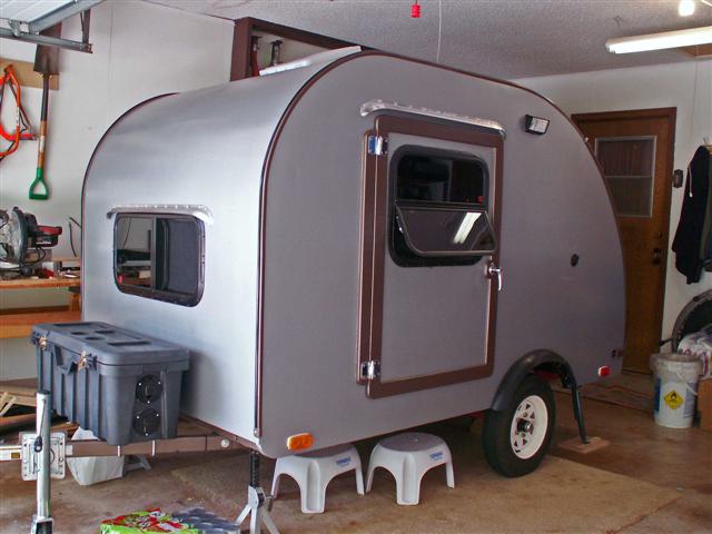

I managed to find a light weight box at Lowes. I put a piece of 3/4" ply in the bottom and use it for a battery box and misc other stuff (the box is vented and has a couple of electrical "cord ports" mounted in the side). It is mounted to the HF tongue using using 2 U-bolts per side (you can see them in the pic).
Like someone else said, the tongue weight got a little heavier than I wanted, but placing my 40lb. Coleman Event shelter behind the rear axle balanced things out just right.
