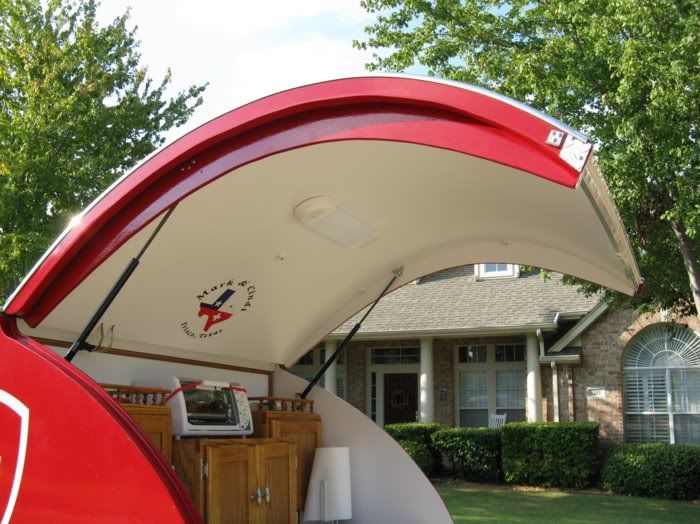

There are two schools of thought when installing hatch struts. One is placing the mounting point on the hatch near the hinge and the other is placing the mounting point on the galley wall near the hinge. I went back and read many threads on this site about both ways. While many make it work, I have seen more problems with the hatch mount placed near the hinge. My TV has a hatch so I decided to see what they did. It has the hatch mount mounted down the hatch. That is what clinched it for me. I mounted the struts with the mount on the galley wall about 8" from the hinge and the hatch mount toward the middle of the hatch. My hatch is heavy (about 70#) and I used 150# struts. They work great. I can lift and close my hatch with one finger.
I got my struts from McMaster-Carr. They are as described: Gas Spring With Threaded Ends, 150 Force, 26.38" Extended Length, 10.24" Stroke.

Postby planovet » Mon Apr 05, 2010 12:10 pm
SteveA wrote:But the way that the 120# struts were trying to pull up the hinge on the body side
I think that can be a problem with the struts oriented the other way. Also, be aware that when you put your skins on your hatch will weigh a little more. You don't want your hatch coming down when the wind pics up.
