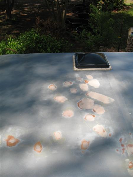

When I was putting the CPES on today I noticed two splits in the forward outer layer of the roof luan (I don't see the roof up close too often, 'cause I'm short).
This first one looks to be a split in the very thin outer layer of the luan, but it is about 6 1/2" long, you can feel it with your finger. By touch, it feels ridge like. It is more noticeable in real life than it is in this picture:

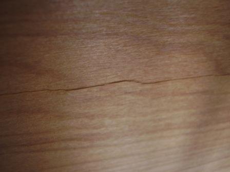

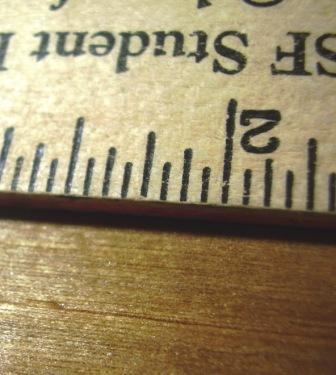

The second looks more like a crack in the wood, this one only 1" in length, just a few inches further down and parallel to the other, and I got a better picture of this one.
So how do I fix them? Do I just put epoxy filler in the grooves, then sand them? I liberally painted on CPES today, I know it is going to need more than this.

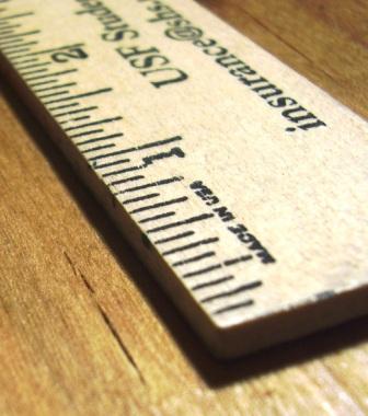

Postby Alfred » Sun Apr 11, 2010 6:09 pm
Hey gang,
Found 3 or 4 more of these cracks this afternoon, a few fair sized ones on the front face of the camper now. Here is a picture of part of one of them, several inches in length.
It seems like they are appearing, or getting worse, after I applied the CPES yesterday(?)
