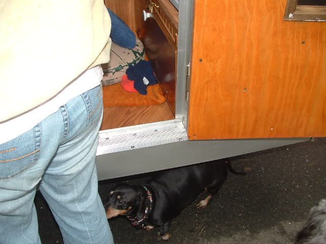

Saw several different takes on waterproofing the doors. I will attemp to post a few.

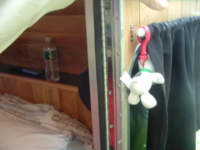

This fellow had a really cool camper. said it spent one year building it. He used aluminum angles along the back side of the door opening with waterproofing seal applied to the angle. Looks like he made the aluminum thresshold. I liked this.
Here is the top view of the same door. You can see thwe aluminum angles a little better, I hope. Image

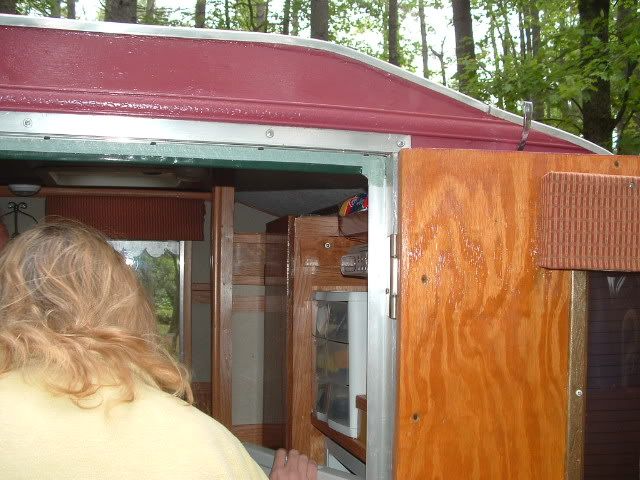

Here is one that used piano hinge and wraped the door edge and the door opening with aluminum angles. He used a pice of regular roof flashing to cover the edge of door, so no wood would be exposed if the angles did cover the edge of door. That was a neat touch.
