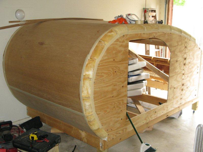

Has anyone used Bondo Hair, or a similar fiberglass strand reinforced body filler on their builds?
I need to do some contour molding on my body (The teardop trailer body that is :D ) and I do not want to end up with a 1/2" thick wall of bondo that is going to crack when I hit a pot hole.
My thought was to use the Bondo Hair for the major contouring and final coat it with regular Bondo.
I might add that I have no idea what I am doing here :R
Any of our resident glass experts have any advice?
Thanks,
Wes

Postby WesGrimes » Sun May 23, 2010 6:59 pm
But what if I do need to fill more than 1/8"?
The idea behind the Bondo Hair is that it is a bunch of fiberglass strands mixed with Bondo. If I understand the product correctly, you can apply it much thicker, and the embedded strands of fiberglass will keep it from breaking.
Ageless, Is the window screen reinforcement still needed at just 1/8" thick?
Thanks for the guidance.
Wes

Jerry,
I have been using both 2 part PU foam and the Great Stuff canned PU foam to make my shape that I am now covering in glass.
The thing is, I have gotten a little carried away here and there with sanding the foam down. Adding additional foam to the existing foam would be possible, but a royal pain in da rear. I have chosen to cover it in one layer of fiberglass, and then fill it up to shape with *something* and cover it with a couple of more layers of glass before fairing and painting.
P.S. I have used both the pour and mix and canned foam and I can tell you with out a doubt that the pour and mix is WAY BETTER! I ordered mine from Jamestown distributors.
Thanks,
Wes
