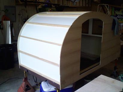

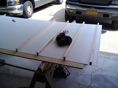

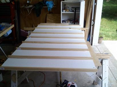

Current build for a customer required white fiberglass shower panel as a ceiling, in a light weight camper. So with trying to eliminate any extra wall thickness and weight, we decided on 1/2" ply walls which made routing my usual rabbit for the ceiling to nest in out of the question. So I laid the panel out on horses, attached the spars to the top side with adhesive, and laid the whole panel in as 1, attaching the spars to the side walls as we moved up. Worked great!

Excellent Dan. I like this method much. Thank You for showing this. :applause: :applause: :applause:

I wondered if you might be able to do it that way and have nice finished results....Thanks Dan

You were absolutely "thinking on your feet"! :thumbsup: ...Impressive and well done. Thanks for sharing.

great idea. I put the spars in first, but this is much better. how come I didn't think of it?

we did that very thing on our first build except we were using bendy ply...worked doggone good :thumbsup:
