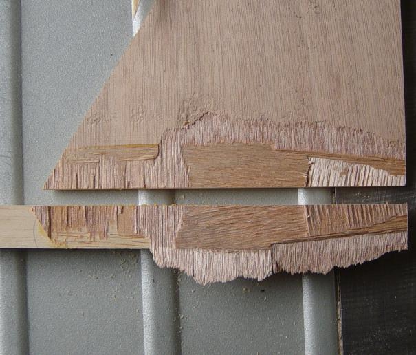

This is what happens when you take out the screws and try to pry apart a wood frame that has had enough Titebond III used. The wood gives before the glue does:
And, yes, sawdust mixed with Titebond III makes a handy filler.
