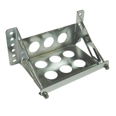

You could build a battery box in the floor of your teardrop or use a pre made one like this one from Summit Racing.
I've installed 2 of these in the three teardrops I've built.
They are great if you have the road clearance.
If you do it this way make sure you make a trap door to access them. :D Danny
Those are real nice, but I can't find them easily on their website. Do you have a brand name, please?

Here's the one offered atSummit Racing
It has gone up in price at Summit Racing :roll: .
I found it for $14.34 less from a supplier on EBay
:D Danny

I also used a bolt in battery tray,. but I ordered it from Speedwaymotors.
I think it was about $35. Mounted it onto the torflex axle.

tkteardrop wrote:I also used a bolt in battery tray,. but I ordered it from Speedwaymotors.
Now that you reminded me that's were I get mine.
I get catalogs from Summit & Speedway every month and get them mixed up.
Speedway Battery Box
:D Danny
