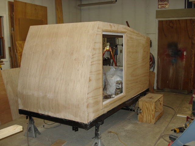

Postby XxXBDrockXxX » Wed Jun 16, 2010 7:49 am
XxXBDrockXxX
Posts: 7
Joined: Mon May 03, 2010 7:30 pm
Location: Indianapolis, IN
I will put better pictures later
Postby XxXBDrockXxX » Wed Jun 16, 2010 7:51 am
XxXBDrockXxX
Posts: 7

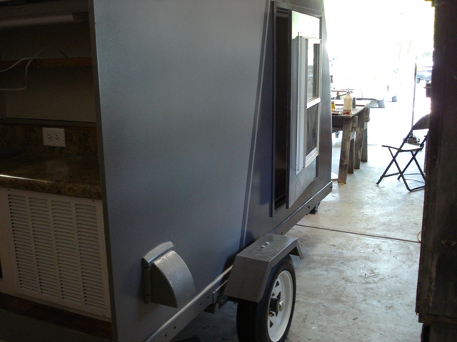

Postby bobhenry » Wed Jun 16, 2010 9:14 am
If you lay a straight edge on the door first top to bottom then hinge side to latch side is it cupped in either direction ?
Can not tell from the pics is it simply a plywood door or is it multiple layers to add some strength to the door?
Postby Steve_Cox » Wed Jun 16, 2010 9:26 am
Looks like a good place for adhesive backed flexible magnetic strip door gasket. "fills the gap, keeps out the crap" 8)
Design wise, we once had a fellow who's trailer only got wet inside whilst going down the road at speed. Cause: his design sucked, literally.
Steve
Steve_Cox
Posts: 4903
Images: 196
Postby Endo » Wed Jun 16, 2010 4:14 pm
Use thicker weather stripping along the bottom of the door.
All 4 sides do not have to be the same thickness.
Use whatever fills the gap.
If the door is warped then additional wood framing may be needed on the interior to help straighten it out.

Postby Gage » Wed Jun 16, 2010 4:34 pm
Looks to me that it's a simple door. I think I would go get another piece of flat plywood and build another because your problem is most likely because of a warped door. Take the door off and lay it flat on the floor and see what it looks like. :thinking:
