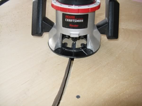

In the pic below it looks like the router made the slot in one pass. If at all posible if you are template routing, trace your template onto your piece and then using a jigsaw cut quickly to about 1/8" to the line, then replace your template and route the piece flush. Since you have removed most of the wood it is MUCH easier for you and the router to route the wood. This is even more important with 1/4" shank router bits.
