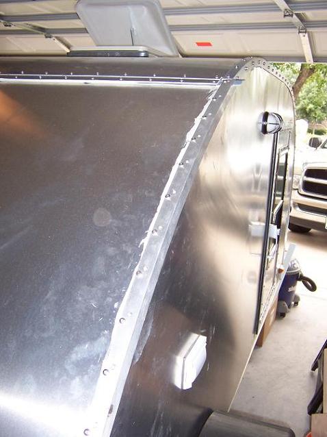

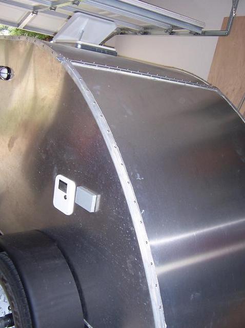

Postby chorizon » Wed Jun 30, 2010 6:52 pm
The left side was the first to get the trim and it turned out quite nice...
The right side was more of a PITA. I had to relocate my holes. This piece will be replaced soon. I am embarassed to show this, but I hope it helps someone else out there... :thumbsup:
I used 1 X 1 X 1/8 6063 Architectural Aluminum that I pre-drilled, then annealed.
