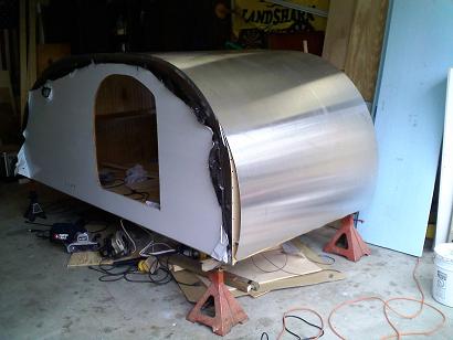

Postby prohandyman » Fri Jul 02, 2010 4:30 pm
VTX
As you can see in the pic, all my campers are built before the frame is slid under. I use a ladder and step up inside and build Steve Fredericks method, cabinets and all. Actually this pic is after we dropped it down from dead level 36" saw horses. I build my units high as I have back issues, then lower them down to jack stands as I near completion, then after exact measurements, have the frames welded, then back them underneath. Works for us.

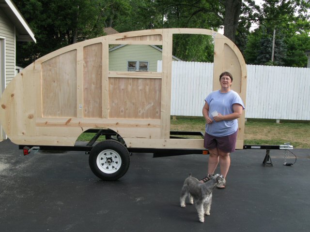

Postby vtx1029 » Sun Jul 04, 2010 11:21 am
Thanks guys. This looks like the best route for me to go. Now to decide if I keep the wheels inside the camper body or have them outside. Plan is to do a weekender type body 6' wide.

Postby GregB » Sun Jul 04, 2010 1:19 pm
vtx1029 wrote:Thanks guys. This looks like the best route for me to go.
Are you sure about that? I thought having a girl in my trailer was "the best route for me to go" too,... until Holly found out :D .

Postby vtx1029 » Tue Jul 06, 2010 11:03 am
That is my wife 8)
