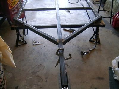

Postby bledsoe3 » Tue Jun 21, 2005 8:21 am
Here is the basic frame. I used a 3 foot tongue as suggested.
I used 2"X2"X1/8" for the frame and 2"X3"X3/16 for the tongue. I think it looks O.K. for a rookie. It's even square!

Postby asianflava » Tue Jun 21, 2005 12:40 pm
Frame looks good! :thumbsup:
I opted not to put the rear cross member because the axle will serve that purpose. It won't support the floor but it will tie the sides together. It's only a 15lb difference.

Postby JunkMan » Tue Jun 21, 2005 7:56 pm
I added some diagonal braces to the tounge of my frame to strengthen it.

Postby bledsoe3 » Tue Jun 21, 2005 8:18 pm
JunkMan, I'm putting in braces just like those as we speak. I'm also puting in some 2"X2" angle iron 6" pieces on the inside of the frame to attach the floor to.
