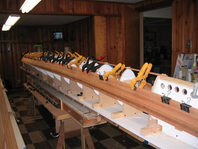

Postby Larry C » Thu Jul 22, 2010 11:13 am
timlsalem wrote:I just looked into your album and can't see any pictures of what your doors will be made from. Could you post some of the sides your planning to cut the doors from?
I can't post pics of my actual sides yet because I am not that far.
All I have is the outside perimeter laminations done.
The construction will be 1/8" x 3/4" Cedar strips in an artistic pattern directly over 3/4" internal framing with foam insulation between. Fiberglass/epoxy over the strips. The finished wood will show. The inner wall skin will be 1/8" Russian Birch. Total sandwich wall is 1" thick.
Doors will be cut directly from the walls. Because the strips will be a finished pattern, they could not be duplicated. I can't mess up the doors while them cutting out or any other reason such as warping.
If I can make my 3/4" internal door framing so it won't twist or warp, that's all I need to accomplish. I have had enough experience with large panels not staying flat, including house doors, to want to make sure I do it right the first time.
Look at Juneaudave's stripped side walls to see the wood strip method I'm using. However, I am not stripping over plywood as Dave did. My outer wall will be 1/8" thick.
Here's a pic of the wood strip method I will be using for my outer wall/door skins:
Larry...
