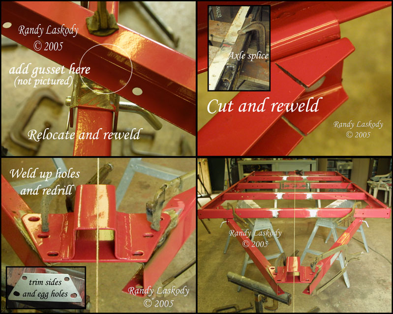

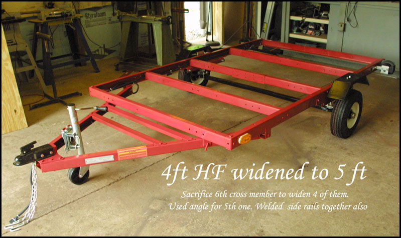

how to widen the 4 ft HF haulmaster to 5 ft with pics!
Postby rlphoto » Mon Jun 20, 2005 12:24 pm
Takes about 8 hrs and saved me $300 dollars.
Randy

Postby IraRat » Mon Jun 20, 2005 1:51 pm
I brought this up in your other post, but I just saw this now:
You welded the front and back sections of the side rails together, and added a small gusset at the weld, not pictured?
--Ira

Postby rlphoto » Mon Jun 20, 2005 3:19 pm
IraRat wrote:I brought this up in your other post, but I just saw this now:
The gusset is not at the joining of the main frame rails. The gusset is where I had to move the front tongue mount. After relocating it, there is not the same original weld area, so I had to create some.
On the main frame there is a piece of angle iron that is the spring mount. that bolts over top of the joint. I feel this is suficent to give it enough strenth, since they are never welded to begin with.

Postby Joanne » Mon Jun 20, 2005 3:31 pm
rlphoto wrote:Takes about 8 hrs and saved me $300 dollars.
Randy
Randy,
Nice job and pictorial! That whole "a picture is worth a thousand words" thing is really true when building a tear. I think that this same process could be used for any of the bolt-together frames. Like everything else on these trailers, it's time and attention to detail that makes the difference.
I converted a small H-F trailer into a motorcycle cargo trailer and had to do the opposite by narrowing everything by 6 inches. Turned out great.
Joanne

Postby s4son » Mon Jun 20, 2005 3:54 pm
Is the axle made from C-channel?

Postby rlphoto » Mon Jun 20, 2005 5:15 pm
s4son wrote:Is the axle made from C-channel?
Yes. A piece of 1 1/2 x 1 1/2 square tube fits nicely for a splice with a slug in each end for added strenth.
Randy
