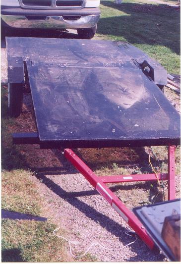

I had a bit of extra lexan and decided to install a rock guard on the frame right before I installed the floor.
I guess I was just ahead of my time. :lol: :lol:
