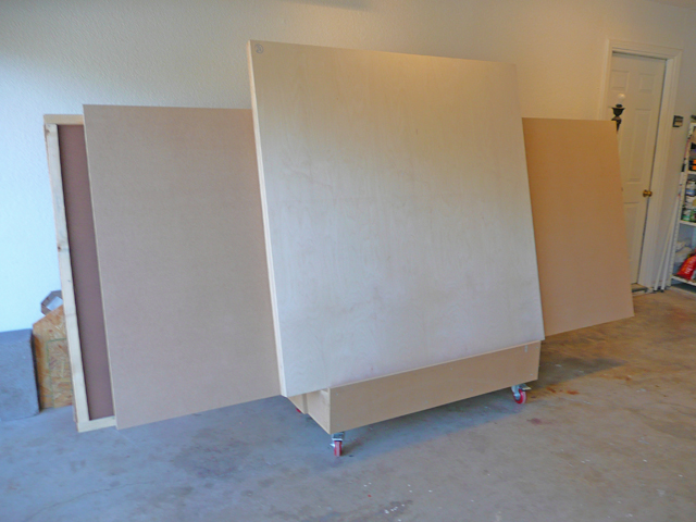

I hope this isn't going to confuse things, but I stored my plywood on edge in a cart I built. Some of it sat there for 6-7 months before I got around to needing it.
The cart is about 4 feet wide. In the picture below, the square sheets are 5' x 5' baltic birch. Behind them are some 4' x 10' sheet goods. The longest item is a pallet I made to hold my 4' x 10' aluminum.

Another reason I stored my plywood on edge is that my work area is 1/2 of a two-car garage. With my tools, workbench and assembly table, I didn't have 32 square feet (or 40 square feet in my case for 4' x 10' sheet goods) that I could use for material storage.
