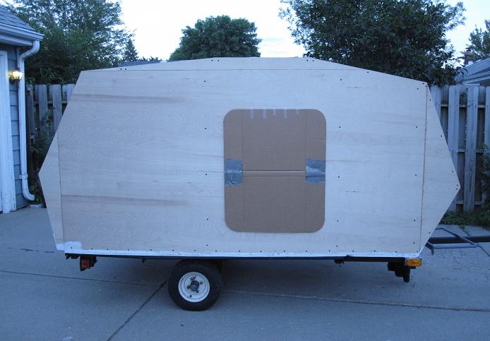

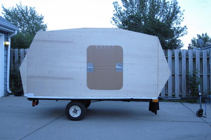

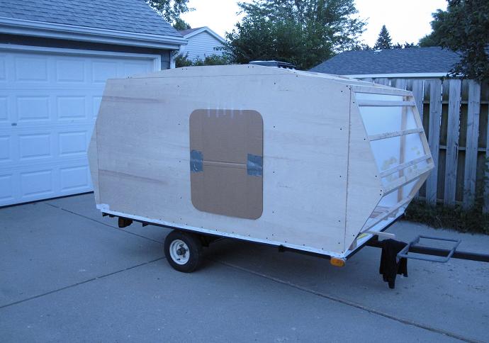

Postby MKE_Tear » Mon Aug 09, 2010 8:35 pm
steve smoot wrote:No matter how long it has taken, you are doing a nice job... :thumbsup:
Thanks, Steve!
I've purchased tools I never thought I would own (table saw) to tools I had never even heard of (Kreg jig). It's an adventure every day!!

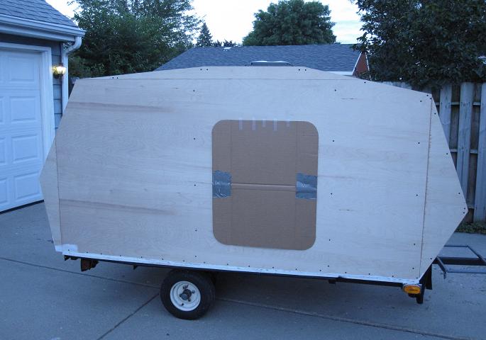

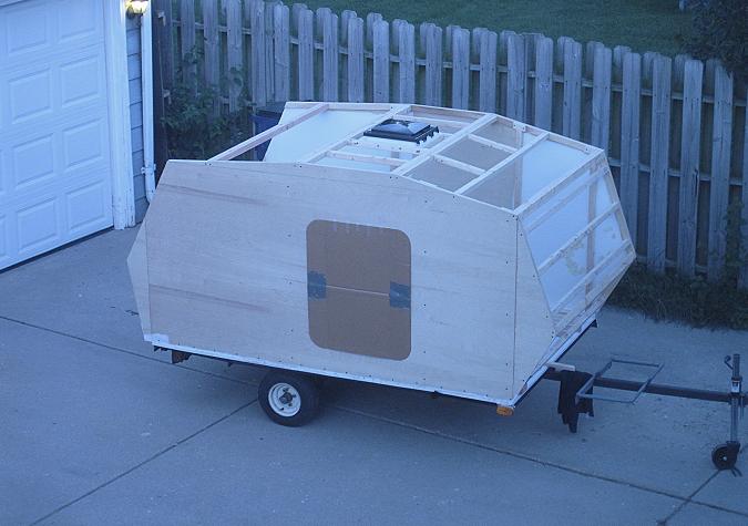

Speaking of...today I fixed up the (hopefully!) "final" template of the doors. (Thanks to absolutsnwbrdr he told me how to put them in -- if you haven't seen his build, you'll be blown away: http://tinyurl.com/zketeard ) Anyways, I hung it up and think the doors need to be raised an inch or two. Currently, they sit right below the height of my shoulders.
and, my favorite shot of them all, from the second story (I call it the snooper):
MKE_Tear
Posts: 130
Images: 243
Joined: Sat May 08, 2010 6:28 pm
Location: Milwaukee, WI

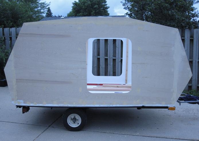

Postby MKE_Tear » Wed Aug 11, 2010 8:23 pm

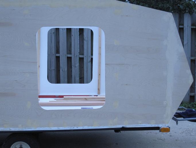

I cut the holes tonight...
Hole #1:
Hole #2:
And wifey makes a special guest appearance:

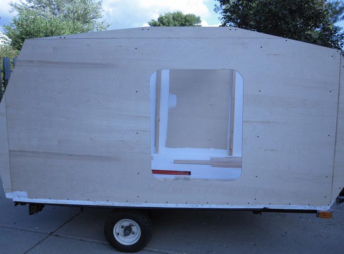

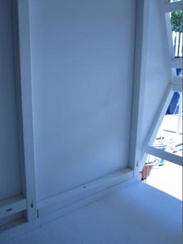

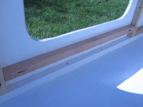

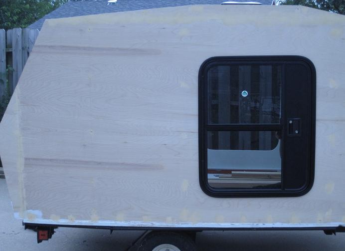

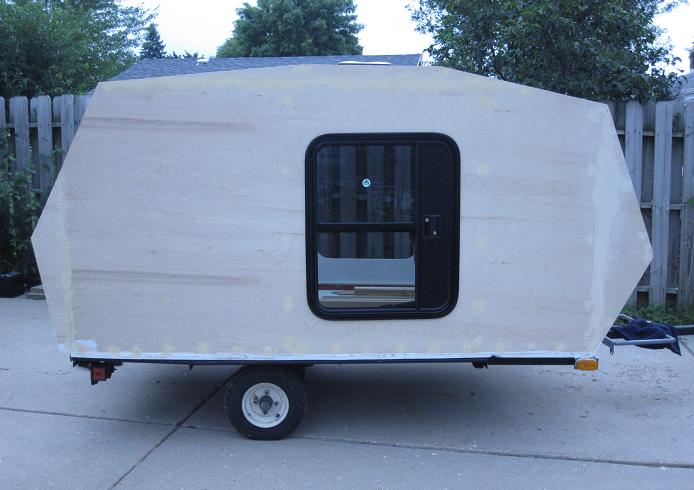

Postby MKE_Tear » Sat Aug 14, 2010 3:26 pm
Not much of an update but...
1. The height of the door was raised one inch (before the cut -- should have said that earlier),
2. Primed the rest of the inside (been doing 3 coats to be extra-sure/safe),
3. I have been filling the screw holes and the gaps where the plywood was stretched, and
4. Test fit the window -- I can see progress!!
Anybody ever used/heard of aluthane?
(Aluminum Filled Urethane Metallic Coating)
http://www.epoxyproducts.com/aluthane.html
http://www.epoxyproducts.com/dataaluthane.pdf
It's a metallic coating or moisture cured urethane and I'm going to cover my outside plywood in it. Instead of a two-component system like epoxy, you just roll it on, and you can put another coat on in 1-2 hours. I ordered a gallon and will report back afterwards. Hopefully, I will get it next week and can put it on over the next week or two.

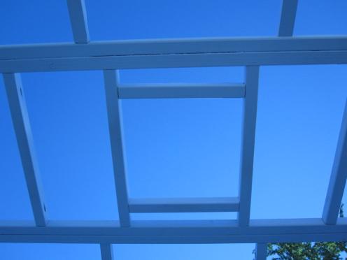

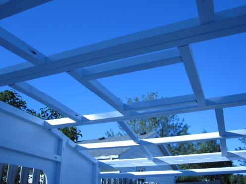

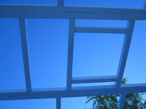

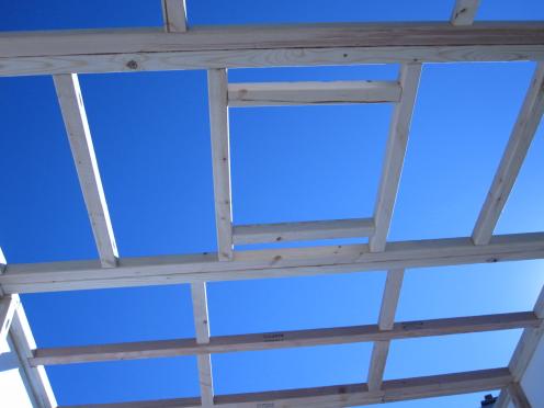

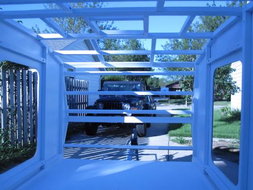

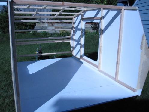

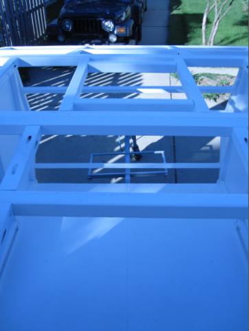

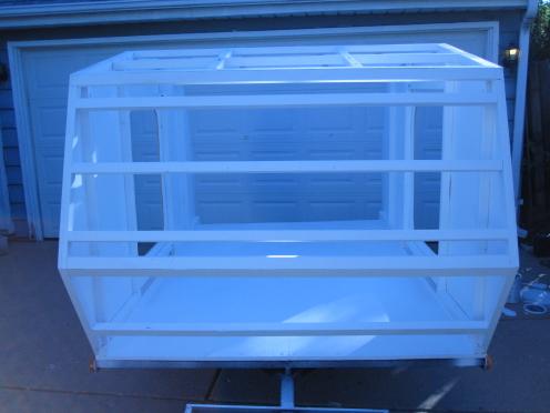

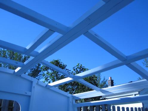

Postby MKE_Tear » Mon Aug 16, 2010 5:11 pm

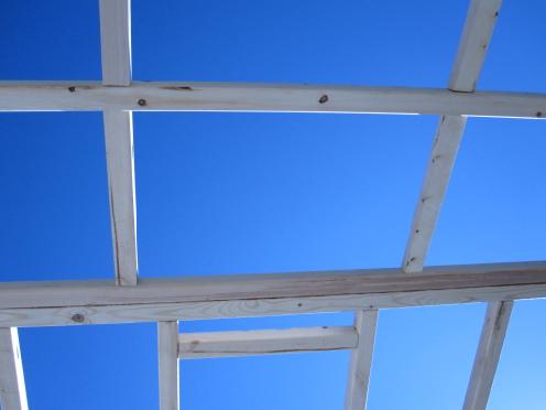

From fear of this...
I got out the power sprayer & primed the frame (studs/spars/supports).

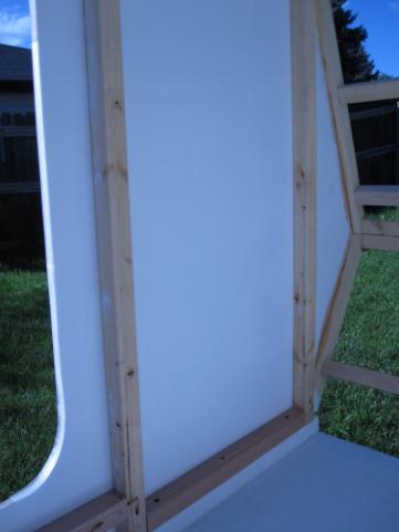

Here are the before shots:
to the after shots:
Now I've got a skeleton. :D
MKE_Tear

Postby Cliffmeister2000 » Mon Aug 16, 2010 5:17 pm
What's your towing capacity? That looks like it's going to be heavy... :thinking:
God Bless
Cliff
♥God. ♥People.
1 John 4:9-11
My Teardrop build pictures
Cliffmeister2000
Titanium Donating Member
Posts: 3621
Images: 157
Location: Phoenix, AZ
Postby MKE_Tear » Mon Aug 16, 2010 5:19 pm
Vehicle is 2,000 and the trailer is 1,500.
EDIT: Changed as of May 2011...got a new tow vehicle. It's towing capacity is 3,500 (not that it should really matter much).

Postby Cliffmeister2000 » Mon Aug 16, 2010 5:22 pm
My trailer weighs in at 1,340, and I used 1x lumber for the framing. I hope you meet your 1,500 goal! :thumbsup:

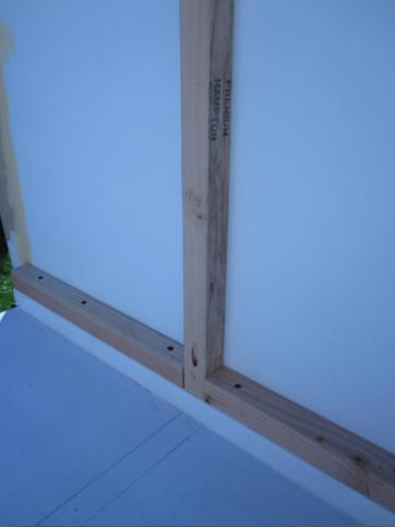

Postby MKE_Tear » Mon Aug 16, 2010 5:34 pm
Cliffmeister2000 wrote:My trailer weighs in at 1,340, and I used 1x lumber for the framing. I hope you meet your 1,500 goal! :thumbsup:
Me, too! 8)
I put in a lot of (potentially) additional/extra spars & studs but each round or series really firmed things up. I realize you need some flex but it felt like it had just a bit too much. I just don't want to see the thing blow up in my rear view mirror. :?

Postby Cliffmeister2000 » Mon Aug 16, 2010 5:44 pm
The real strength comes from the skin on the frame, creating a torsion box. The frame does not have to be very strong.
